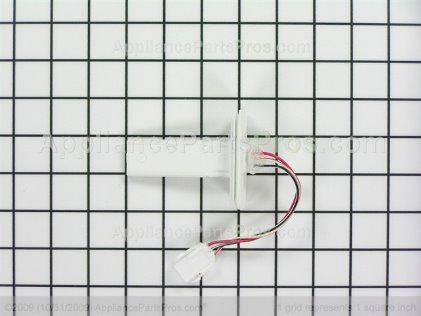

Here's the water level sensor for this model:
WPW10485962

Im guessing by you posting the photo of the water level sensor you are saying its the issue, I ran it in diagnostic mode had blinking light while reservoir was filling, it didnt fill all the way up nor did i get a solid light, as it got close to being full the unit went to step 6 on diagnostic chart. Guess the max time elapsed.
125,425
Put the original control board back in then try it again.
Yes, it sounds like the water level sensor is possibly the problem, the service manual on page 4-6 says this--->NOTE: The water level sensor cannot be checked with a meter - use the diagnostic program step #10. See Figure 17.

Jake there were no changes when switching control boards. Replaced the water level sensor and as of now everything seems to be in proper working order. Thank you so much for your help.
125,425
Excellent wes, glad to hear the new water level sensor fixed it.(y)
