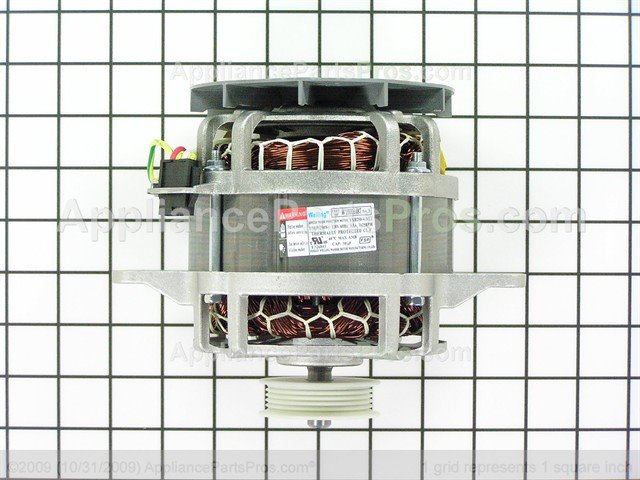

Here's the motor for your model you can order, if needed:
W11283592 Motor-Drve

Since the motor spins the tub fine with no issue, wouldn’t that rule out the motor as the culprit?

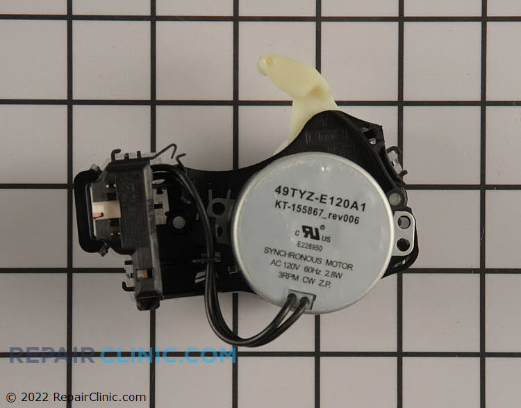

Disregard what I just said, I was thinking of the older style.
I located another thread with this same problem, and the problem is the shift actuator.
Look here:
Your model uses the exact same shift actuator:
Shift Actuator W10913953
137,440
Yes, I'm glad I remembered that.:)
That should fix it, yes keep us posted. 🤞
137,440
Excellent, glad to hear the new shift actuator fixed it.(y)
