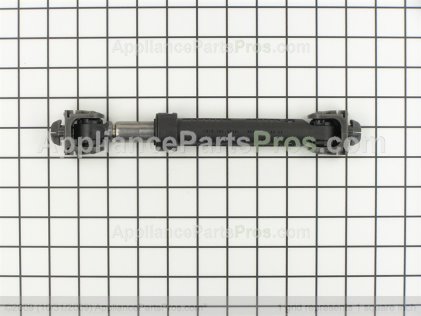

Does the tub seem to bounce too much with a load in it?
Its possibly the shocks that's causing this WHEN a load is in it.
The shocks do not have a lot of resistance on them. They should move fairly easy on the unit, but should not be very loose. They shouldn't be bottoming out or leaking any grease/oil. Also for any cracks in the shocks plastic casing as well.
Here's the shock absorbers for your model:
Shock Absorber WP8182703

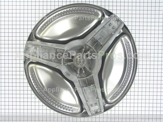

If the shocks are good, then its either the outer tub bearing has gone bad or the inner tub spider support arm is cracked or broken. Only way to know is to take the inner tub out and see.
Here's the inner tub assembly for your model which includes the spider arm supports:
Inner Tub WPW10250573
