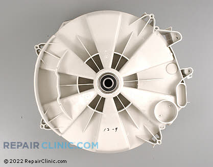

My old Sears Kenmore front loader is making a very loud noise on spin. Its like an airplane! No clanging. I called a repairman (did not make a house call) and he said I should buy a new machine.
Thanks for any ideas. We have replaced parts a few times on our own so thought this might be possible. At any rate we've gotten our money's worth out of this washer:)
That jumbo jet taking off sound is usually the rear drum bearing.
So you'd need a new rear outer drum assembly OR the bearings itself.
If you have plenty of time on your hands and up for a challenge then you can follow the steps to replace the bearings alone in our main thread on this issue here: [FIXED] Drum Gasket and Rear Shell Bearings
Here's the outer rear drum assembly which includes the new bearings already installed(video included):
Rear Drum with Bearing 131525500
