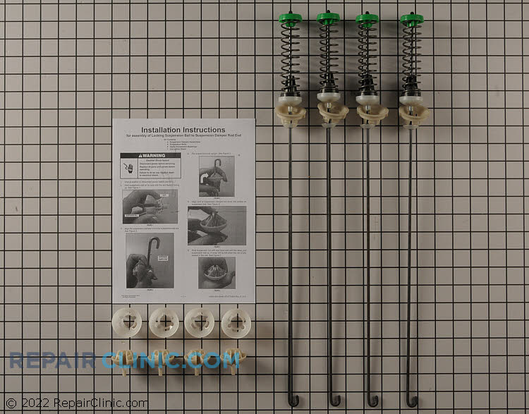

I replaced the suspension rods with OEM from Repair Clinic as suggested in a previous post, but the washer is still shaking violently... Maybe not as much as before the new suspension rods but... not good. I double checked all were seated properly and that the drum bounces right back into place, recalibrated the machine, and it is still banging around. Any thoughts?
Here's the OEM suspension rods for your model:
W11130362 Suspension spring kit
Without clothes in the washer on spin does the tub bang the sides of the washer cabinet?
