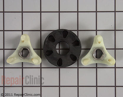

Our Kenmore washer, model #110.15842400, has been having problems spinning the water out of loads completely. Until today, it seemed to spin lighter loads well, clothes/items came out damp but not soggy like heavier loads did. Today, the washer stopped spinning all together. The motor runs and sounds like it is trying to spin, but the tub does not move. Not sure if it's moving during other portions of the cycle, as I don't want to start a cycle and not have it drain the water out, and be stuck with a washer full of water... help! what is causing washer not to spin? would it be more economical to purchase a new washer, as my husband thinks? this washer is only ~5 years old.

Check your motor coupling, to make sure it didn't break.
Motor couplings are the most common part to go out on these models, as its just like a belt, and can just wear out over time.
Here's the motor coupling for your model you can order if needed:
Motor Coupling 285753A

Well I replaced the motor couplers and now the washer is spinning again. HOWEVER, the first load of wash we ran came out well extracted, but the following 2 loads we ran were progressively more wet after the cycle. Seems like there may be something else wrong with the machine. Any thoughts? :confused:
Sherry (aka. "Lewis-the-dog")
139,315
Yes Sherry,
Then its likely the basket drive/clutch assembly as I pointed out above.

I'm reviving this thread because I am having a similar issue with my Kenmore 110.15862400. Would the parts recommended above work for this model? It makes a pretty loud noise when the clutch engages and begins spinning. I recently replaced the coupler because the basket was not spinning and that fixed it. However, clothes are progressively coming out wetter and wetter. Water appears to be draining properly too. I'm willing to replace parts on this thing as long as it keeps running after repair because it's been a trooper over the years. Plus, it's not real difficult to work on. Thanks!
139,315
Yes, your model takes the same parts I posted above in post #3.
