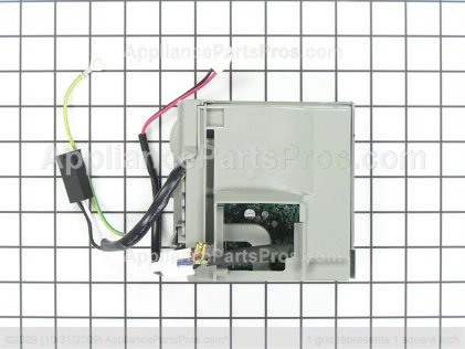

Here's the inverter for your model:
W10893917 Invrtr-Box

Thanks Rick and Jake. I was able to get someone out here today from across town. They say it's the inverter and it's not putting out 230VAC. I tested it myself after he left and am getting only 30VAC.

Go in through the back of the connector. Be sure your meter test lead is touching the metal wire end in the connector. If your meter leads are too big to go into the back of the connector use my safety pin trick:
Don't overthink this. It breaks down to this; The compressor windings are correct so you need two voltage measurements, 120 VAC constant at the black and white wires and 3-6 VDC constant when the machine is calling for cooling. I wouldn't worry about 1 VDC. The signal voltage is a square sine wave and many less expensive meters can't read the voltage correctly. If the voltage is correct and the compressor doesn't run, bad inverter. If the signal voltage is not 3-6 VDC, bad board. If the supply voltage is not 120 VAC check for a broken or pinched wire between the power cord and the inverter.
