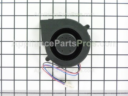

Here's the ice box fan motor for your model:
W10846539 Fan
See the ice maker door in this video above his head? The air should be blowing in there.
If the ice box fan intermittently kicks on, its possibly bad.
I'm attaching the tech data sheet for your model below. You will need a multimeter to do voltage checks. Then get access to the Ice Box Fan and check for 14 Volts DC across any of the 3 wires while in Service Test 36 with the fan ON . If the voltage is correct then your Ice Box Fan is bad and you will need to order it.
