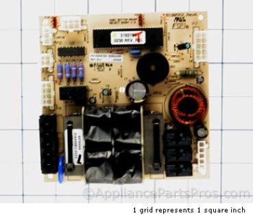

And now it’s back to how it was before. The back cover in the freezer is covered in ice.

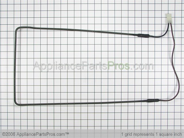

What could be the cause of no defrosting? Bad heat element? Is there a defrost timer?
Bad control board?

If the defrost thermostat ohms good(shows continuity) while frosty, then either the defrost heater or control board is bad, this model doesn't have a defrost timer. The control board controls the defrost cycle rather than the defrost timer.
Defrost heater:
Heater, Defrost WP2006750
W10823805
Watch this video to ohm test the defrost heater:

He did ohm test while frosty.
Would it be a bad idea to replace the control board with a previous version? And would a bad control board cause my wonky inverter board on/offs?
I salvaged one from a similar Kitchenaid and the part number shows as being replaced by the one you listed.

I ordered the control board from the link you posted. Also called the tech back and we’ll see what happens.
Hope the new board solves my issues.

I spoke with him today and he did mention that he tested the heating element. He didn’t think it was the main board because that would have given me issues with not enough power to lights in the fridge. Ive had issues with the ice maker that I’ve never seen before. The rake stops at the 7 o’clock position almost as if the mold heater isn’t getting enough power causing the cubes to not get ejected.

If the defrost heater and defrost thermostat ohm's good, then only part left that controls auto defrost is the main control board, plain and simple.:)

I think it’s finally completely fixed. The tech came back to install the new control board and after that, tested the defrost and now the defrost heater wasn’t working. He was back this morning to install a new heater. The old one had a big crack in the bottom of the element. Maybe I didn’t need the new board but I’m hoping it’s good for another 20 years.
