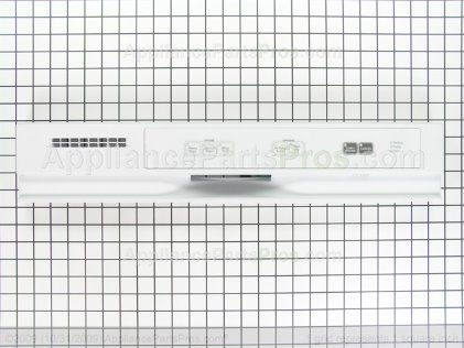

On this model when you get any blinking lights, its a short in the control panel touchpad assembly.
Here's the control panel touchpad assembly for your model:
WPW10250008 Panel-Cntl
