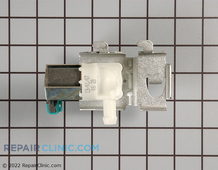

During the cycle, everything is fine. After the cycle, it starts to leak near, what I think is the supply line. It stops if I turn off the supply. See below:
edit again, here is an image, zoomed out for an idea of the location:
I tried to put some Gorilla Glue putty/sealant on there to no avail.
Any ideas? Thanks in advance!

You will need to replace your water inlet valve, that's the only way to stop it from leaking.
Here's the water inlet valve for your model you can order:
Water Inlet Valve WPW10158389
