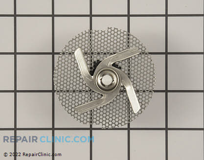

Hi, I'd first check your sump basin and chopper screen for any foreign object that might be making that noise in the chopper screen blade assembly, also check the black flapper check valve in the video below as well.
Watch this video below first, Paul tells you what to check in the sump basin and chopper screen :
Check your chopper screen blade assembly to make sure its not broken also.
Here's the chopper screen assembly for your model:
Food Chopper Assembly W10083957V
Here's the video to check/change it:
If nothing in the chopper screen is making that noise, then yes its the wash motor starting to go bad, OR you can have a foreign object in the wash motor impeller too, but you'd need to remove the wash motor to check that as well.
