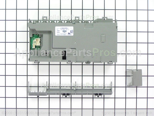

OK, I replaced the Control Board, but the Heat Dry light still will not light up.
Diagnostic mode reports back no errors. The heating element was hot after running through the cycles.

Is it possible that the water is heating during the wash cycle but heat dry isn't on and I don't know it because the light isn't on. Heat dry button still beeps just no light.

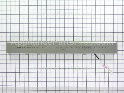

Ok, yes that is possible. But is the heating element HOT in the dry cycle? If not, it could be a short in the control panel(keypad and console) for that heat dry button.
Do this below:
- Unplug dishwasher or disconnect power.
- Disassemble door and disconnect keypad connection from control board or LCD display module.
- Verify all other connections to control board are made.
- Reassemble door, but do not close door.
- Plug in dishwasher or reconnect power.
- Wait at least 7 seconds for control board to power up completely.
- Close dishwasher door and monitor control board response:
A. If control board is OK (no longer sees stuck keys with keypad unplugged), it will respond by turning on the drain motor for 2 minutes. Replace keypad and console.
B. If control board is not OK (still sees stuck keys with keypad unplugged), it will not turn on drain motor. Wait for at least 10 seconds. If there is still no drain response, then replace control board or LCD display module (whichever one the keypad was connected to).
Here's the control panel(keypad and console) for your model, if needed:
WPW10537336 Panel-Cntl (stl)
