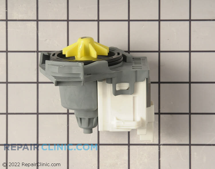

Hello,
I'm coincidentally having almost the exact same issue with my dishwasher of the same model. It is giving me code 8-2 and is frequently failing to drain. I hear the drain pump humming during the drain cycle (like it's trying to spin but can't).
I removed the drain pump to have a look, expecting to find something clogging the impeller, but to my surprise it was all clear. I've checked the drain tubing for any kinks or obvious signs of blockage - there was none.
While I had the drain pump removed I tested it and saw that the impeller did spin.
Tried disconnecting the vent, but unfortunately saw no change in behavior after doing so.
At this point my best guess is that the drain pump is dying so I've ordered a replacement. Anything else to try while I wait for the part to ship?
Yes usually the cause of the drain pump working intermittently is the drain pump itself is faulty.
To Verify that--->You will need to stay at the dishwasher and when it doesn't drain you will need to check for 120 volts at the drain pump.
You will need to remove the electrical connector from the drain pump and get a multimeter and set it on AC Volts, then put your meter leads in the drain pump electrical connector that you remove from the drain pump, then WHEN IT SHOULD BE DRAINING see if your meter reads 120 volts. If so, and the drain pump is not running, then your drain pump is bad.

Hi Jake,
Took out the multimeter and saw that the connector was reading exactly what you told me it should.
The new drain pump arrived yesterday, swapped it in and it’s working perfectly again!
There were no obvious signs of failure on the old pump, so I suppose something internal must have been failing. Regardless, thanks to your help, the dishwasher is up and running once more!
Excellent Kevin, glad to hear the new drain pump fixed it.(y)
