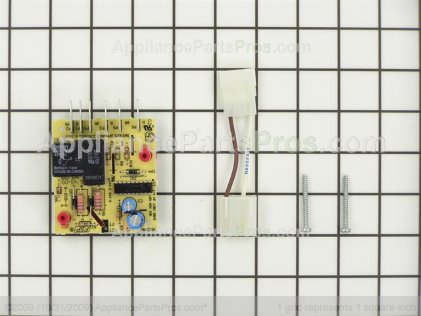

I'm attaching the schematic sheet below, Look at #3(red wire) on the electronic defrost control, that powers the evaporator fan motor, through the #1 terminal(red wire) on the air baffle assembly, then goes to #2 terminal(red/white) on the same air baffle assembly, then to your evaporator fan motor per the refrigerator thermostat contact.
So, if that refrigerator thermostat: Temperature Control Thermostat WP2161460 ohms good, then its either the electronic defrost control not sending 120 volts to the to air baffle, thus to the evap. fan motor, or your air baffle has a broken circuit in it, or you have a frayed/broken wire between the red/white wire and white wire that go directly to the evap. fan motor.
Here's the electronic defrost control for your model, if needed:
Defrost Control Board 4388932
