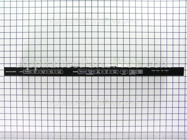

If your getting 120 volts between P4-2(black wire) and P4-1(white wire) on the control board, then your bi-metal is good. It could also be a faulty control panel(user interface) per the tech. data sheet.
Panel-Cntl WPW10500087
