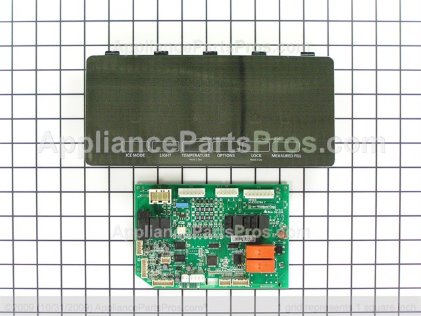

On this model they upgraded the control board to a service kit.
This kit contains both the high voltage control board and user interface. Both parts must be replaced together. Disconnect the power before installation to reset the logic. After installation, set freezer temperature to the recommended -2 degrees Fahrenheit.
Here's the service kit for your model you can order:
W10878993 Cntrl-Elec

The control board will be easy to replace as it is on the back of the unit. Can you tell me how to remove/replace the User Input panel on the front? I can't seem to find any information on how it comes out.

The service kit comes with complete instructions to replace both parts.:)
Hi Jake,
Well I installed the control board kit and ran the fridge for 6 hours and neither the refrigerator or freezer compartments even got cool. They were basically room temperature. I didn't pull off the panels to look at the evaporator coils but they couldn't have gotten very cold and the compartments stay at room temp.
I don't know what else to do other than call a Whirlpool tech to work on it. I don't think I can replace the refrigerant valve and really can't afford to just keep guessing. Thanks.
