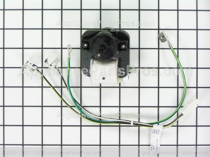

Here's the evaporator fan motor for your model, if needed:
W11024089 Motor-Evap
