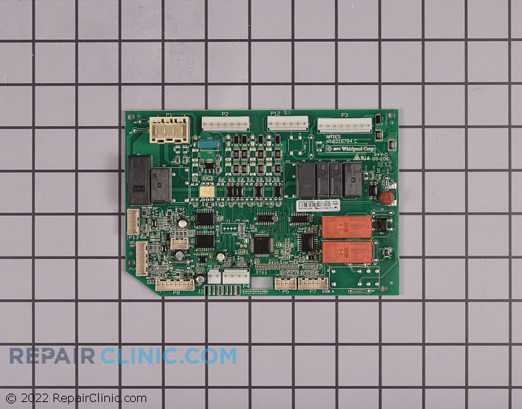

P3-5 to P1-2 is the door switch volts on the main control board, check at the main control board for 120 volts AC when the freezer door is closed.
Here's the main board for your model: WPW10743957 Cntrl-Elec
Here's the photo of it:
Here's your tech. data sheet below.
