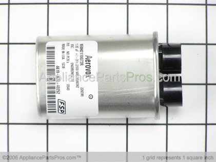

So, as recommended by someone else, I replaced the big 1.15mfd cap connected to the Toshiba magnetron and checked the adjacent diode... (OK). Still having same problem. When microwave runs, all the lighting (inside the microwave oven AND the below oven (I manually turned it on to watch without the bottom oven actually being on) and led panel lights intermittently dim and the magnetron sounds like it's about to stall out, then everything recovers and runs normally till the next "brown-out". Happening randomly... can happen several times in a row for a few second each, or may only happen once over a period of 3-4 min run time.

RESOLVED!!! Turns out that upon further inspection, two of the wires in the molex connector on the high side (220V from the wall), were singed/charred and they MELTED the connector and the electrical contacts were touching intermittently. Must have been a bad capacitor that was causing a LOT more current to be drawn than should have been. So after changing the microwave capacitor, I replaced the melted Molex connector, made all new connections and voila... it WORKS!!!!

Here's the microwave capacitor for your model, in case others need it too:
Capacitor WP4375020
Note to others: ALWAYS discharge that capacitor FIRST:
