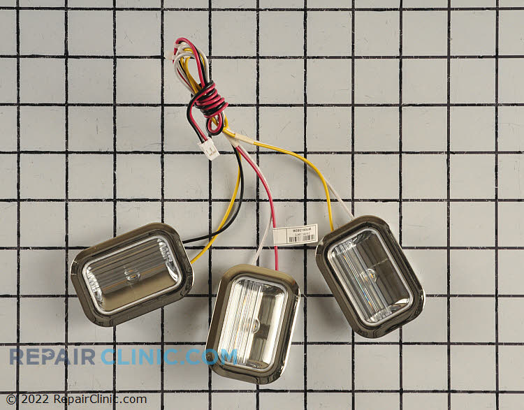

Hi all, this is for my Kitchenaid KRFF507ESS. It's 2.5 years old.
There are 5 "ceiling" lights in my KRFF507ESS. A few weeks ago 2 turn off (the front two) and the other 3 were flickering. As of today they're all off. No other issues with the fridge anywhere (lights or termp). Any ideas or any other questions I can answer?
Pic below to show the lights off and the side lights on.
THan
Thanks for the response! Do I need to order 5 total or once I fix the right 3 will the left 2 come on?
Just the link I posted above that come with the three in one set, then the other 2 will work again too.:)
Sounds good, yes keep us posted.:)
No dice. Lights flickering now except for the 4th one which just is off. Do I try to replace those too?
Interesting, those 3 you replaced are coming on now, yes you will need to order the other 2 on left side now, but I would just order 1 which is the one that is just OFF, that seems to be the one 1st in series.
Here's the left side top ones:
LED Light W11462342
If they're running in series why would the first ones flicker? Shouldn't they be fine or will one of the 4th/5th somehow cause upstream issues? Trying to figure out all possible issues here. Thanks!
Because the LED that is OFF is the first one in series and that affects the others downstream, so just order and replace that one that is OFF, and the rest will work fine.:)
Hey Jake, I've only found videos on how to remove the reservoir side of the lights. Do you have a suggested video on how to change the lights on the side with the ice maker? Thanks!
Lights are on!
For anyone else coming here, you do not need to take out the ice maker in order to get to that light. Follow this video and just pop it out. Beware, they DO NOT come out easily. Thanks for all the help!!
Excellent Cory, glad to hear that left side top LED module fixed it. (y)

Here's the FREEZER LED for your model: W10695459

@Jake , I am having the same problem as RTPatterson on my KRFF507HPS00. Referencing your post above; Is the freezer LED in series with the lights in the top of the refrigerator cabinet? Will jumping the +/- legs supply power up to the top of the fridge?
Yes, the freezer LED is in series with the TOP refrigerator LED's.
It should per the instructions I posted above. I have not tried it yet on my local customers, because I always replace the freezer LED and it fixes the LED's in the refrigerator section too.:)
Here's the freezer LED for your model:
W10695459 Module
Just got back from inside the freezer. Yes, jumping the pins on the freezer light got the lights in the ceiling of the fridge cabinet going. I'm sure wiring it this way saves 20 - 25 cents per unit but, really, what the actual hell are they thinking? Anyhow, thanks for the direction!
