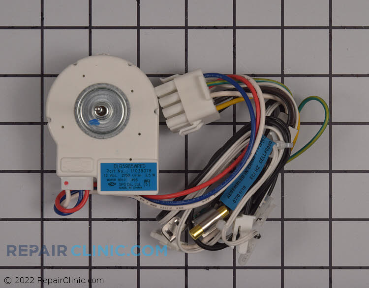

Here's the FC fan motor assembly for your model below, See the brass looking thermistor bulb with the clip on it in the photo below? That's your defrost thermistor.
On this model the defrost thermistor comes only with the F(freezer)C(compartment) evaporator fan motor assembly. Its in-stock here: W11249952
