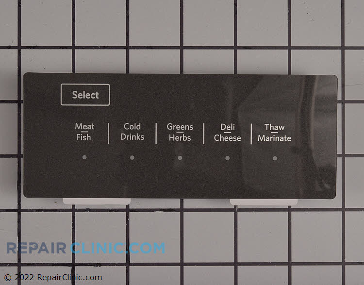

I have a KRMF706ESS01. I was having issues with the lights not working, the dispenser stopped dispensing water or ice, the door alarm would go off when the doors were closed, and the ice maker had water in the tray, but wouldn't get cold enough to form ice.
I was told it could be faulty door switches, and if not that, a couple of different control boards. I tried new switches, which didn't help.
On a whim, I removed the produce drawer UI board. Which turned on the fridge side lights, the door alarm went away, ice is now being produced, and the fridge started dispensing water and ice again. The top lights still aren't working, but show really really dim. Seems as if just the pantry drawers and side lights in the fridge work.
If I plug back in the board, everything stops working again.
So my question is: Why? Is it a faulty board or more likely a faulty wiring harness? Is there a different board that controls the top lights that may not be working?

For this current issue, yes usually the Pantry UI Board is the cause, but also check the wire harness that goes to it. Here's another person that had this similar issue:
Here the Pantry UI Board for your model:
User Control and Display Board WPW10769076
Its in-stock here: WPW10769076
Here's the wire harness to it:
Pantry Drawer Wire Harness W11170612
Here's the video to access it:
I put the new control board in this evening. Door ajar alarm started going off again and everything stopped working. So I am guessing this means I need a wiring harness and the old control board is fine? If so, that's good. Way cheaper. However...... That video looks daunting!
Yes, then you need the wire harness, just follow the video and just have patience while your replacing it, and it will go well.:)

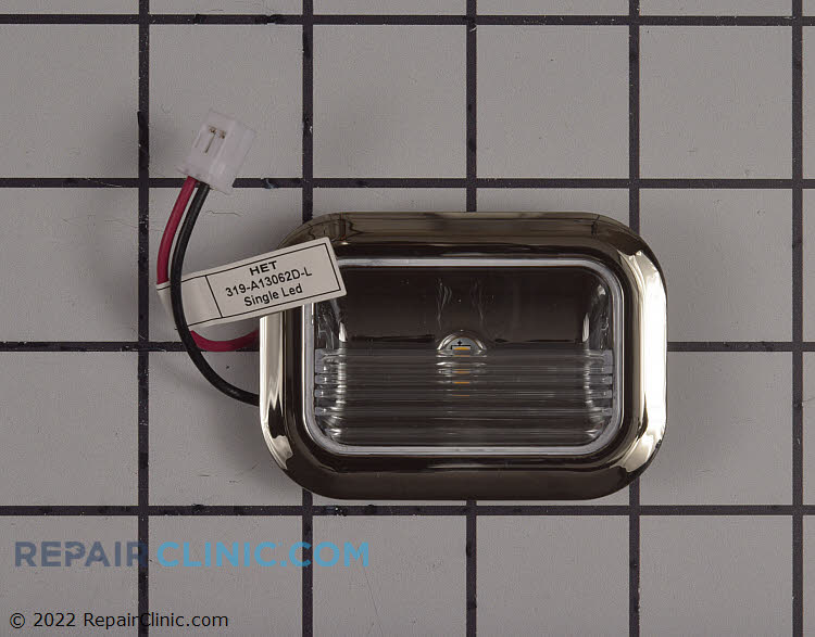

Is the freezer LED light working?
On your model, the freezer LED is in series with the TOP refrigerator LED's.
Its usually the freezer LED that's bad and makes the TOP refrigerator LED's in the refrigerator not work either. You can remove the freezer LED and check for 14 volts DC to where it plugs into that electrical connector.
Here's the freezer LED light for your model:
W10695459 Module
For the pantry drawer issues, recheck those again, sounds like you may not have put them in properly, since they were working fine before.
Thanks! I'll give them a check. Maybe I over tightened a screw.
Any ideas on the fridge doors?
Thanks! I took the right one off and the green plug was installed wrong. That fixed the right door. I checked the left and it was correct, but seems to still be a little clunky. I noticed some rips in the right door gasket stripping (not sure if that is the right word for it), so wondering if that might be causing this issue.
On another note, I checked the freezer light and it to is dim. So it doesn't seem as if the light is broken. What would be the next step on this? Freezer and three top lights are dim and the two lights under the ice maker are off. The four side lights, pantry drawer lights and lighting under the shelves work fine
These LED lights run in series(like the old Christmas lights, if one goes out or dim they all go out or dim), if the freezer LED goes out or dim it makes the TOP LED's in the refrigerator either go dim or completely out.
Replace the Freezer LED module and it will also fix the TOP LED's in the refrigerator section.
Also, what you can do is use a jumper wire and jump each LED to see which one is bad. When you jump the bad one, the rest will light up in that series.
Make a jumper wire, and jump that Refrigerator LED and see if the rest light up fine.
It worked for this member:
If the FREEZER LED is good, then next one in series is the LEFT TOP FRONT/BACK one.
Here's the LEFT TOP FRONT/BACK one in the refrigerator section:
LED Light W11462342

I changed out the freezer light. Now that light and the top lights are completely out. Not even dim.
Then you got a bad LED light, where did you get it from?
You'd also need a new refrigerator door gasket, per your photos of it above, its torn.
Here's the refrigerator door gasket for your model: Gasket-Fip (blk) W11544658
Yes, we see lots of problems with parts from Amazon and Ebay.
The OEM lights came in. Turned out to be the light you stated in the refrigerator under the ice maker, far back. Everything is as bright as an airstrip now. So bright, I'm tempted to put the bad light back in 😂
