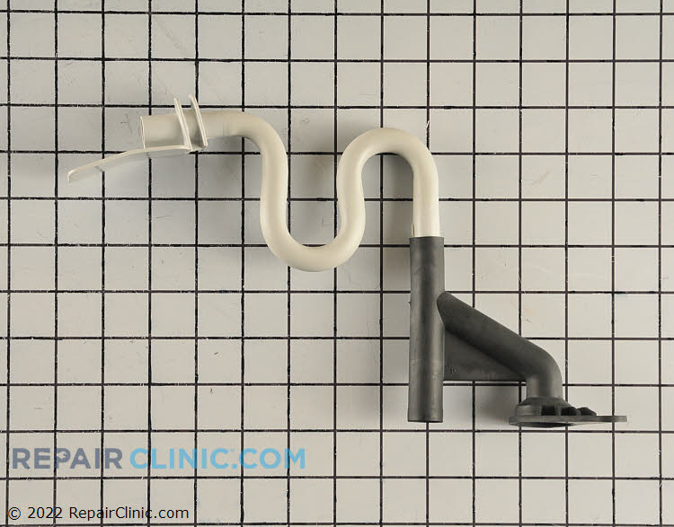

Hi
Model is KitchenAid 5 door fridge KRMF706ESS01
Water stays underdrawers.
I checked and cleaned the S-shaped drain pipe.
What would be the problem and how to unclog defrost pipe then .thanks

You can get at the drain tube from the back of the refrigerator.
Here's the drain line assembly for your model:
Drain Hose W11084807
This video shows you how to access to clear it out:

Yes, the drain line from the evaporator coil drain trough that goes to the drip pan is still clogged up, Use compressed air to blow it out, then run hot water down it.
