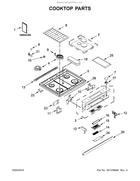

giving me a F2E1 stuck key error. "Clock/Tools" key won't allow clock reset/adjust. Denied power (breaker) to device but error reappeared. Everything else is working fine (temp, baking choices, etc.). Just can't reset clock and continue to get error code.

You will likely need to replace the key panel if it is sticking:
LINK> #3 Panel Control
