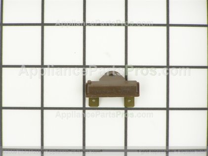

After replacing the baking element and the oven still not working, I grabbed my multimeter and tested the temperature sensor (tested ok) and the thermal fuse (bad.) However, after replacing the thermal fuse the oven still will not heat. The induction top works as it should and all of the controls on top operate as one would expect.

You replaced this thermal fuse?
Thermal Fuse WP3196548
You ohm tested the new thermal fuse and its good?
