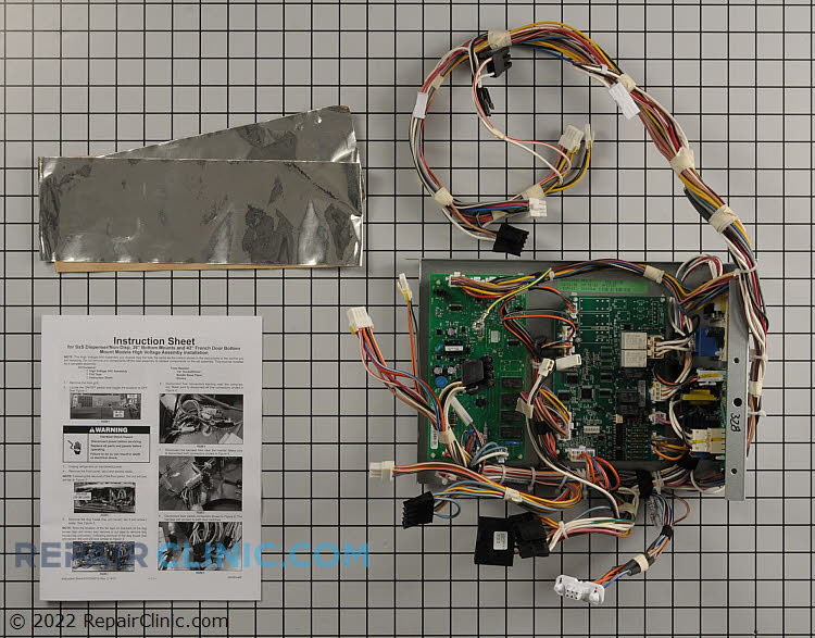

A local service provider (arranged by Whirlpool) came to inspect my KSSC42QTS00 without any resolution and follow up. In the meantime I ran the Service Diagnostics routine as indicated in the Service and Wiring sheet. The RC code stayed at 00 when it was supposed to indicate 01 or 02. Does this mean that I need a new main circuit board?

So the compressor and fans don't run at all?
Yes, the problem is possibly your control board has gone bad.
They no longer make the original Control Board, its been replaced with this Service Kit:
W10789107 Electronic Control Board Service Kit
It comes with complete instructions to install it.

Got my control board back. Installed it back and the compressor and the fan are still not running. I found power to inverter unit, however no power to fan
137,353
Then they did not repair it properly, let them know. Because that board controls power to the condenser fan motor,
