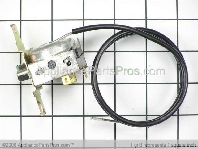

After all the reading I have done, I believe it is the Freezer thermostat. The type with the dial. I believe it is beginning to fail and when it does, does not sense the warmer temp to send the compressor on.
I will keep you posted on the next few days, but if anyone wants chime in and comment, please do.
NOTE:
- My compressor is newer and quiet as a mouse. It runs fine when on.
- Even when warm temp is exhibited, both the condenser and evaporator fans are running.
Yes, I agree with you. That can be starting to fail after all these years.
Here's the freezer thermostat for your model:
Thermostat, Temp WP1113466
