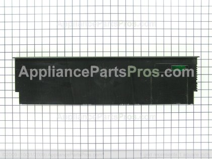

First look at the ribbon connector between the console and the control board. Make sure there is no corrosion on either connector and it's all the way on the pins.
If it looks good, replace the console:
WP8572349 Console

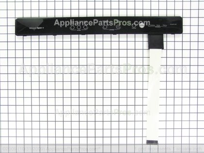

Or could I simply use this instead, WP8531873 Interconnect ? From the parts diagram, it doesn't look like there are any additional electronic components with the "console" vs the control panel, except maybe a new ribbon.

It seems that the "Console" is the "interconnect" being sold with the plastic housing. The "interconnect" is just the individual circuit board as a standalone part. And the overlay is just the face plate...Is this correct? If the above outlined procedure results in the drain pump being activated, then which of those 3 parts would I need to replace?
So essentially I disconnect the interconnect from the front keypanel/faceplate.
I'm going to try this later tonight.
If the drain motor activates after the procedure, then the "Overlay" needs to be replaced, and not the interconnect? I was initially thinking that the 'interconnect" was what people typically refer to as the control panel, but in fact the control panel is the overlay/exterior keypad?
Yes, that's correct. Normally the overlay is part of the console. The interconnect is nothing but a "splitter" . I don't see any electrical components on it. Looks like a "coupler" if you will.
On a typical Whirlpool dishwasher console that's the same style as yours the console and overlay are one part where the keypanel is along the top of the door:

The overlay is what I was referring to when I said console in my first post. You and me both, brother!6c2ba386.x120.gif
Just wanted to say thanks again. I replaced the keypad this morning and everything is now working perfectly. I tore apart the old keypad it was clear that something had burned out. There was a small burn mark on one of the circuits, no bigger than the size of a pin head.
