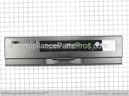

You have a short in your control panel assembly, you will need a new one.
What color is yours?
Here is a new one for your model you can order, if yours is black:
WP8270226 Console Asm.

I got a new control panel with keypad and the brain box behind it, did not resolve. I think the dishwasher stops when it tries to start the pump it uses for the wash cycle. That pump is probably what I'll repace next. Sound like a good idea, or am I way off? I hope I can fix it soon, I hate doing dishes.
121,870
Thats odd, that control panel/touchpad assembly should of fixed it. I have fixed many of these models with the same symptoms of yours.
It sounds like more of a technical issue, I would hate to see you keep replacing parts, I would check for something that could be stuck in your chopper screen area, as described here:
