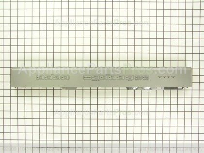

Here's the control panel assembly for your model you can order, if the drain motor turns on for 2 minutes:
WPW10500175 Panel-Cntl
