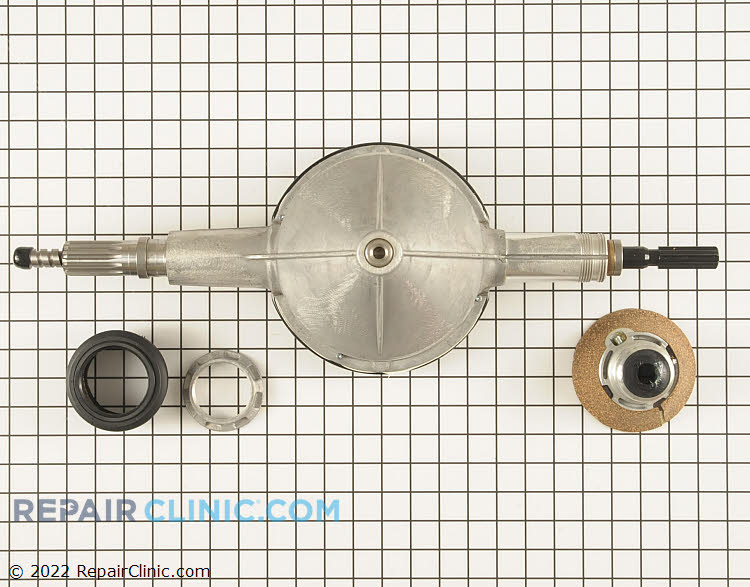

3) Only item on your washer with oil in it and this oil can get onto the cloths is the tranny/gearbox.
LINK> Washing machine Orbital transmission kit for deep tub models - NLA

3) If it is the transmission, I assume water is getting into the gearbox too? There is an O ring available for the shaft...
Is this the faulty part?
As much as I like this machine, I've been entertaining thoughts of replacing it, but I am not sure yet.
Oil can come out without water making it's way in.....but I tend to agree with you, there probably is water in there now :(
If oil can pass one way, water can certainly as well.
That is the upper one seal. Shaft is probably also scored.
