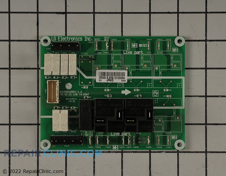

The convection fan in my oven doesn't stop turning when the oven is turned off. It keeps turning all day if I don't unplug the oven. Sometimes it stops if I hit the oven on the back panel. There are two control boards in this model. One is the power and the other is the relay. I think that the problem is with one of these. Does anyone know which one it could be specifically? I don't want to order both. Thank you in advance for any assistance.
139,337
Its the relay board that controls the convection fan motor. Make sure you disconnect power to the range first before replacing it. Its located in the very back of the range, behind the rear access panel. Let us know how it goes.
Here's the relay board for your model: Pcb Assembly,sub EBR80595408
Here's a photo of it:

I installed the relay board three days ago and the convection fan turns off when it is supposed to. Thank you for your help.
