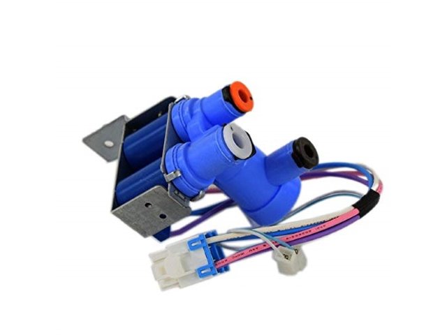

If your water pressure is good, then it could still be the water inlet valve--->The diaphragm in the ice maker side of the water inlet valve may not be closing completely and a small amount of water leaks past. When it gets to the ice maker fill tube, it freezes. When it builds enough ice it blocks the fill tube end of the water line.
Here's the water inlet valve for your model, if needed:
Valve,water MJX41869208
