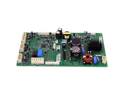

Hi everyone,
So I got this EBR83845003 Pcb Assembly,main online as instructed.
But when I opened the fridge in the back, I saw this EBR86093796:
Is this compatible? Please check out the connections.
Thank you in advance for your help.
Is there a revision number on the model number tag?
If you model number is LMXS28626S/06 then that is yours--->Pcb Assembly,main EBR86093796
