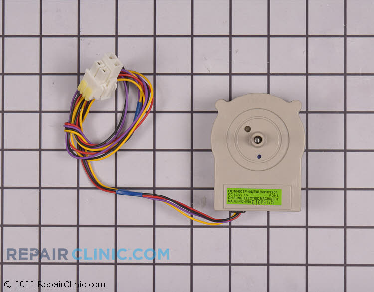

My 1.5 year old LG LMXS30776D french door refrigerator has developed a very loud rattling/buzzing sound coming from inside the rear portion of the Freezer. It starts up a couple times per hour, does it more when the fridge/freezer are being used (open and closed) more and has been slowly getting worse (ie. louder) over the past month. It will stop as soon as you open either the fridge or freezer. I'll post a video of exactly what it sounds like and is happening. It appears to be the Fan that is located inside the back of the Freezer. You can see the fan slow down in sync with the noise and it sounds like it is coming right from it. Can anyone help me find out what I can do and what I need to replace/fix? Thanks so much!

Yes Scott, that's the evaporator fan motor, you'll need to replace it.
1. Remove the freezer drawer.
2. Remove the plastic guide for slides on left side by unscrewing phillips head screws.
3. Remove the grille assembly by removing four screws and pulling the grille assembly forward.
4. Remove the Fan Motor assembly by loosening 3 screws and disassembling the shroud.
5. Pull out the fan and separate the Fan Motor and Bracket Motor.
Here it is for your model you can order:
EAU61524007 Motor,dc

So I took your advice for the evap fan motor listed above. Received and wiring harness and there is no yellow wire on the new one.
I took your advice. Same model # as listed above. LMXS30776D and one less wire and wire harness is different. New motor does not have a yellow wire. Any suggestions?
Ken
Hi Ken, take a photo of your model number tag and upload it here.
The freezer evaporator fan motor with the yellow wire in it is for this model only: LMXS30776D/02
