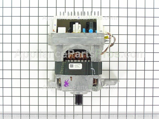

Disconnect the wire harness from the MCU and check for 6Ω across pins 1-2, 1-3, and 2-3. Check for around 117Ω pins 4-5.

No, that's the Central Control Unit. It's the five pin connector on the motor. The Motor Control Unit is part of the motor. You're checking the motor windings.
Your motor(MCU) part number is:
Motor-Drve WPW10315848
139,323
139,323
Excellent, glad to hear the new motor(MCU) fixed it.(y)
