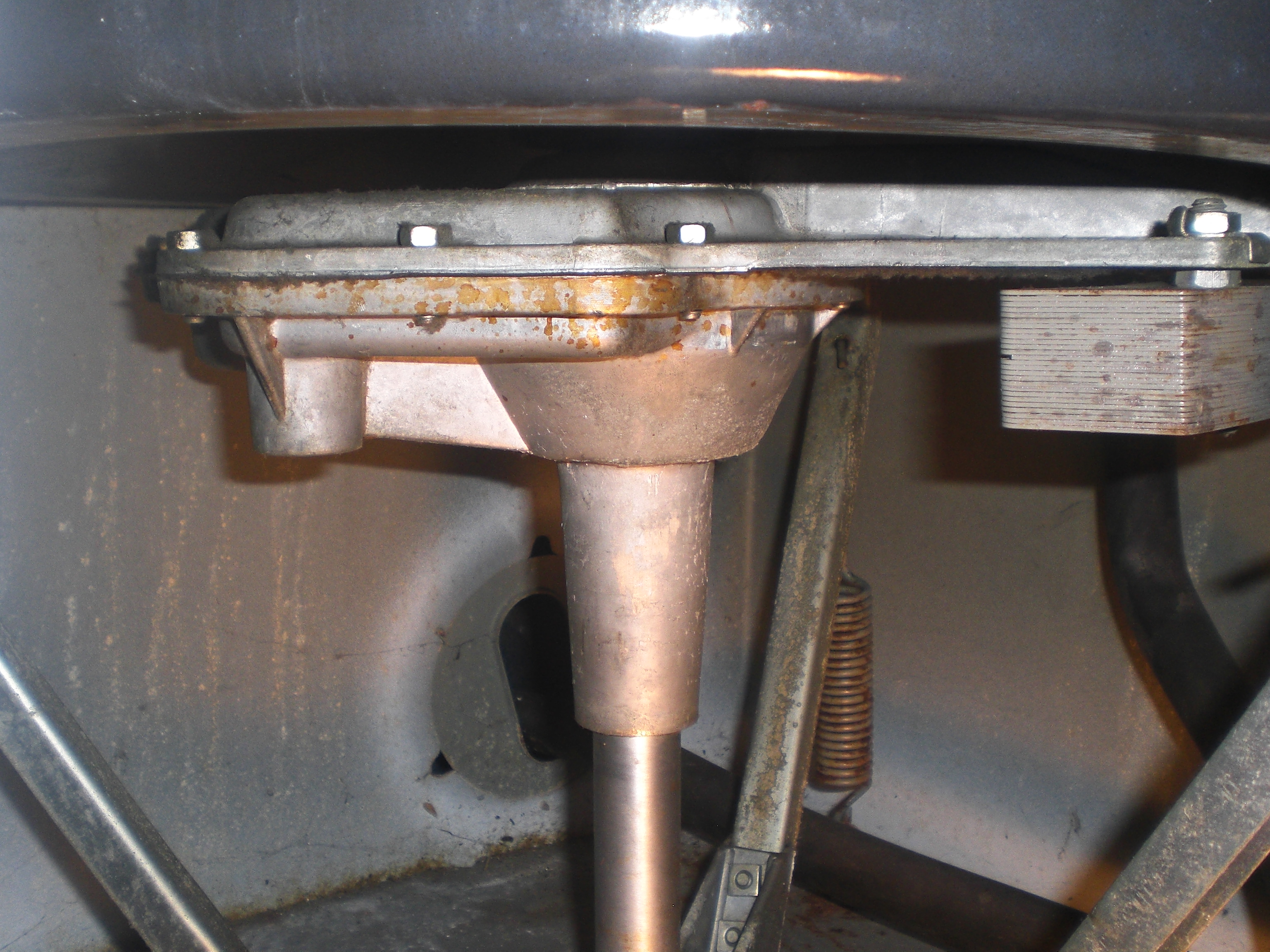

So on a hunch...Because the new motor came in a box full of packing peanuts (lol?) I cleaned it and used some electronics cleaner hoping it was just dirty the motor fired up as if it was new afterwards. then I figured out that it agitates too slow...ok could be a bad bushing in the trans or the oil is nasty, I used a blow dryer on the trans to heat it up a lil....Sure enough it runs as if new.
downside is, I need to replace the oil in the trans, I do not have a service manual for this model series...however I do have lots of experience in the automotive field (I'm actually building a car from the ground up) so I am good with a wrench.
anybody know where I could get my hands on a copy of the service manual so I don't mess anything up while figuring this out?
I was thinking more like cleaning the old gunk out and replacing with new lube, I'm sure I'll still need the tools however thank you for the links, here is a picture of my transmission I didn't know those other trans would work in mine they look very different! lol ...Right now its running its 3rd load, it's a hot water only machine for now...:(
I have the old trans with the counterweight attached.

And the picture of my trans the pictures are kinda large sorry...
http://www.automaticwasher.org//COLLECTIONS/INTERCEPTOR1985//13@Transmission @INTERCEPTOR1985.jpg
If I was to drop the money on a brand new trans, does that new agitator come with a filter? And how hard would it be on the trans vs the old power fin?

This transmission assembly I posted above is the universal replacement for your model.
At $460 for a new transmission assembly you can buy a brand new washer for that price today at Sears during the Presidents day sale.:)
