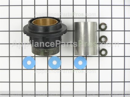

It sounds like your tub bearing is out, very common for this model. But do remove the inner tub first to check for something like a cloth caught in between the inner and outer tub, I've seen that before, and that would cause the inner tub and transmission not to turn.
Its a big all day job to do, so allow yourself plenty of time.:)
You will need to order a spanner wrench to remove the inner tub: Pro TJ90TB123A Spanner Wrench
Here's the tub bearing for your model you can order here:
6-2040130 Tub Bearing Kit - AppliancePartsPros.com
Whenever you change the tub bearing you ALWAYS have to change the tub mounting stem seal kit assembly.
Here's the mounting stem seal kit assembly for your model you can order here:
6-2095720 Mounting Stem Repair Kit - AppliancePartsPros.com

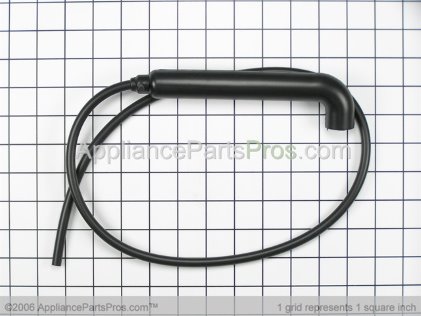

I caused a small crack in the water level pressure switch hose, as the clamp was very hard to remove with the dollar store pliers I was using (all that I had available). Damn! So I went and took my soldering iron and melted it back together as best as I could, and also used super glue. I couldn't find that part available (water level pressure switch), if it needs to be replaced, on either Appliance Part Pros or on RepairClinic. Is it still being sold?
I noticed that the silver sleeve bearing and black rubber seals actually looked to be in pretty good condition! Maybe there was a little friction for the silver sleeve bearing. I sprayed under the sleeve bearing with the Liquid Wrench Lubricating Oil, but I want to use the correct grease; see question #1 below.
I do intend to replace the mounting stem and the tub bearing to see if that does anything (still in progress, pending your answers to some additional questions below, while I still have the machine apart). But from my observation, the most friction/sticking of the transmission seems to be at the other, bottom end of the transmission, where it interacts with the transmission pulley.

2.) Is there any replacement available for the water level pressure switch rubber hose? Or any recommendations/techniques/hacks on repairing a cracked hose, in addition to my melting it with a soldering iron?

2. Here's the pressure switch air hose for your model you can order:
WP22001619 Tube-Air

I received the new air pressure hose and installed it fine. I fixed the porcelain rusted chip in the wash basket with the repair kit you suggested, and the basket looks good. :)
I put in all new parts: the tub bearing kit and the mounting stem repair kit. I put in the new spanner nut. I followed all instructions to the letter, making sure everything was hammered tightly, and I let the washer run for three minutes on spin.
