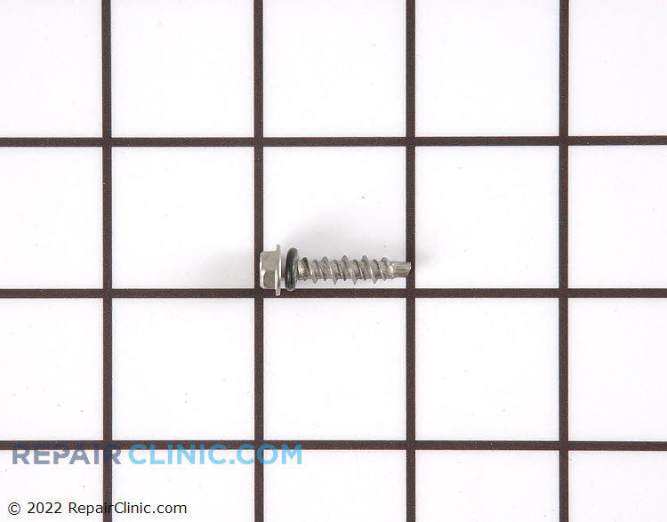

3. For that broken agitator lock screw, I went out and bought a small screw extractor drill bit. I plan to try and reverse out the stuck fragment when I'm feeling daring. Can you point me to a link if they sell new agitator lock screws for this unit? On Repair Clinic, I only see new agitators for sale (which cost $72--a lil' out of budget!!) and one of the agitators for sale comes with the lock screw.
206478 Screw On Appliance Parts Pros, they say the part has been discontinued by Whirlpool. Am I out of luck? I still have the rubber o-ring from the old screw and if I bring the fragments to the hardware store, I'm concerned that what I buy won't be an exact match--like off by a mm or two, which would not fit into the threads or lock into the transmission shaft. Maybe you might have one or can hook me up with someone who has one, and I will pay $6 or thereabouts for part and shipping via PayPal?

3. That Agitator Screw is No Longer Available, and I suggest getting a screw like that at any hardware store.:)
I don't have one or I would mail it to you for free, that just gave me an idea, go to a used appliance shop in your area, most have a old appliance grave yard that will have these old Maytag's sitting around, and they will give you that screw or sell it to you.

I also found another laundry parts site that has the agitator screw for about $4 or so IIRC, but the FedEx ground shipping is like $11.00! I might call them Monday during business hours and see if they can waive the shipping fee or see if I can convince them to send cheaper through USPS... And if you are ever able to locate that screw, feel free to send me a PM. I have a feeling the hardware store won't carry it because it has a unique appearance/layout: hex head on top, threads on middle of screw, and I think a flat part at the end, where it meets and locks into the agitator shaft.

I'm sure a hardware store or machine shop should have that agitator secrew.
Print this photo out of it, or snap a photo of it with your phone:

Gonna have to drill in there with a very small reverse thread extractor bit, and see if the screw comes out. Not worth cutting it out with a dremel tool, 'cause that will cause more problems/damage to the agitator. Then a new agitator costs $75!
Yes, be careful not to damage the agitator!

And some good news! I bought a new agitator screw at Home Depot and installed it. I had to carefully drill out the old screw with a tiny drill bit until it could be removed in pieces. The drill extractor bit that I purchased was too large to fit the hole (even though it was the smallest type, I think, a number "0" type Ryobi brand one). I also put in the new spring with needle nose pliers into the unbalance lever, and it is now securely in place. I ultimately decided to forego buying a new lid switch due to extra cost and because it serves me no function now, other than maybe a "click" noise, seeing as how I bypassed it. So I am still not getting the "click," as I believe the switch is broken or worn, but it hardly matters, as I am otherwise plenty happy with the restored washer, and I am also glad I was able to update a few other components during the disassembly (e.g., air pressure tube, rusted clamps, air injector hose, etc.). I did some rust spray painting, too, after wire brushing things, with some Rustoleum appliance white paint.
