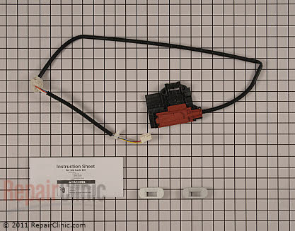

I have the washing machine in the title, we bought it about 3 years ago, but it was used. It will light the "sensing" LED, some water will be start running, then the water stops and the "lid locked" light will start blinking. You can hear and feel the lock trying to latch.
At first, I could remove the red cover on the lid lock module (I'm not sure of the correct term) and toggle the rocker back and forth a few times, put it back together and it would run at least one cycle (sometimes 3 or 4) before the behavior would start again.
Now it won't start at all. I replaced the lid lock module (part number w10404050) and it still won't work. I checked the resistance, yellow and white (J15 1 & 3) was 122. J15 3 & 4 ( white and red) had no value and J15 2 & 3 (blue and white) read 20 which is what the leads show when touched together.
Googling seems to indicate it is the main board, I'm hoping I'm wrong and am missing an easy (and cheaper) fix.

Were you able to get into the diagnostics with your tech data sheet? Then check to see what fault code you are getting?
I'm posting your Lid Lock Switch and the video of how to access and replace it, but I don't want you to replace the lid switch AGAIN unless you get an error code saying to replace it or if it tests bad. The main reason I'm posting your lid lock switch and video is just to show you how to access your tech. data sheet.
Here's the lid lock switch for your model:
Door Latch W10404050
Watch this video below, Once you have the top up, there should be a tech. data sheet inside the front panel.
That's good.
That's not good, LOCK SWITCH should be 0 ohms when LOCKED and OPEN CIRCUIT when UNLOCKED.
That's not good, LID SWITCH--->LID CLOSED should be 0 ohms, LID OPEN should be OPEN CIRCUIT.
So it looks like a bad lid switch assembly, contact the place where you got it from and tell them its defective, and they should be able to send you another one for free.

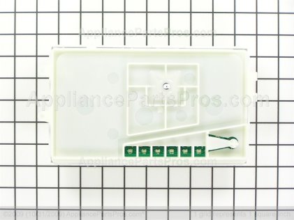

I've replaced the lid lock switch with another from a different seller. I've replaced the latch too, still starts with the sensing light solid, some water goes into the machine, then a load click is heard and the lid locked light starts blinking. Does this mean I need to replace the control board.

Excellent, glad to hear the new control board fix it.(y)
Here's the control board for your model, in case others need it too:
W10480178 Electronic Control Board
