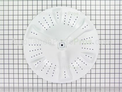

One other part could be the agitator itself stripping, remove the agitator and run it in that same cycle and see if it makes that noise with the agitator off.
Here's the washplate for your model:
WPW10553968 Washplate

Before looking to replace the gearcase/transmission which may be above my pay grade/abilities and not a good ROI, I am wondering if I could have messed up replacing the Drive hub or Splutch cam.
The replacements seemed simple enough and went ok.
I did not notice that when I went to remove the washplate when replacing the drive hub it was somewhat stuck. I was able to get it out eventually without having to force it. Now, when I went to check, I was not able to remove the washplate. It seems to be stuck. Could this be an issue and any advice on how to remove the washplate?
I did check the Splutch Cam and it seemed to move freely with the spring working etc.
I think my next step will be to try remove the washplate

Thank you, that makes sense. Seeing as the Spin and everything else seems to be Ok am I guessing that the Washplate might be problem. If the transmission/gearcase was failing then wouldn't that impact the Spin/rinse cycles s well?
Not necessarily Andy.

Jake, just to let you know, replaced the washplate and no change so it has to be the gearcase then. I looked at a couple of repair videos and reckon I can replace it without too much difficulty. Any recommendation on the best video to watch>?
