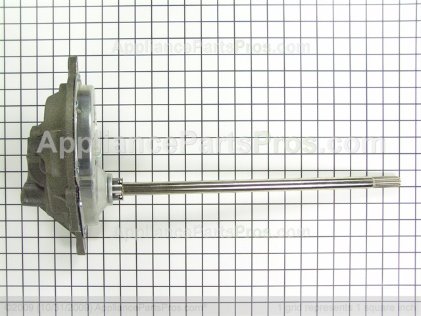

You may be better off getting the complete gearcase assembly.
When I worked at Sears and Wards we techs never went into the gearcase to repair it, we just replaced the gearcase assembly and it always fixed it, so I can't be much more help than what I've already posted for you to go by.
Here's the transmission(gearcase) for your model you can order:
Whirlpool W10140307 Gearcase - AppliancePartsPros.com
