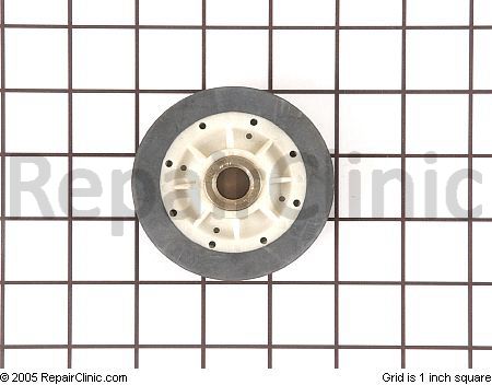

Here's the roller for your model, you would need to order 2:
Drum Roller 37001042 Order now for same day shipping. 365 day return policy. RepairClinic.com

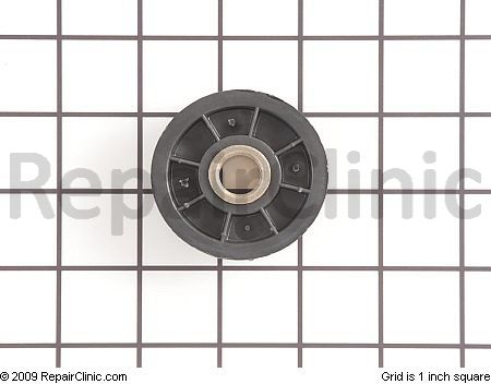

Here's the idler pulley:
Idler Pulley Y54414 Order now for same day shipping. 365 day return policy. RepairClinic.com

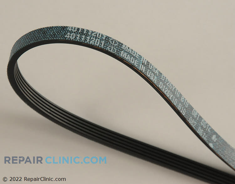

Here's the belt:
Drive Belt 40111201 Order now for same day shipping. 365 day return policy. RepairClinic.com

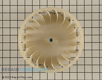

Here is your blower wheel:
Blower Wheel 56000 Order now for same day shipping. 365 day return policy. RepairClinic.com
