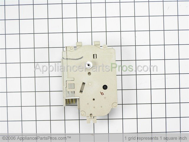

Intermittent problems are the hardest to nail down, but since you found no burnt spots on the control board, it sounds like possibly the timer since you said you hear the timer motor running but its not advancing.
Here's the timer for your model:
WP22002452 Timer
