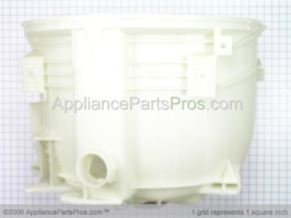

From all my Maytag Neptune service calls, that noise sounds like your rear bearings that are shot.
Now the bearings only come with the outer tub assembly:
22004465 Outer Tub Assy, with Seal Kit
But you can get them locally at a bearings shop in your area, this thread explains all about it: Neptune bearing/seal issues....
But unless you have lots of time on your hands, I wouldn't recommend it. Both jobs are extremely time consuming. But getting the outer tub assembly is more expensive but less time consuming.
I'd say just get a new washer.
