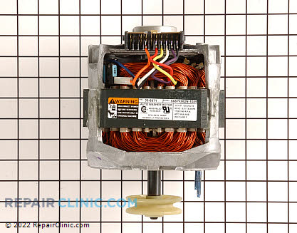

Maytag Performa PAVT910AWW Won't Agitate or Spin and just makes a buzzing noise. I laid it almost flat on it's back but a little tilted upward to check the belt, etc. then decided to try the spin cyle and it start spinning normally. I tipped it back up to standing position and it continued to spin. If I stop it and start it back up then it won't spin and just makes a buzzing noise. Also, when it was spinning and then I stopped it , it squealed/squeaked like the brakes were grabbing.
Update: When sitting upright as it should, the motor is not turning when starting it in spin mode. When laying on it's back, the motor is turning when starting it in spin mode. fyi.
Update 2: Changed the motor and it works. Except something is causing a loud squeak when it stops spinning. Like when the brakes get applied. What can I do to fix that squeak?
Good job finding it was the motor that was bad, thats exactly what I was going to tell you to buy, seen that happen many times on my service calls.:)
Here's the motor for your model in case others need it:
Drive Motor 21001950 Order now for same day shipping. 365 day return policy. RepairClinic.com
