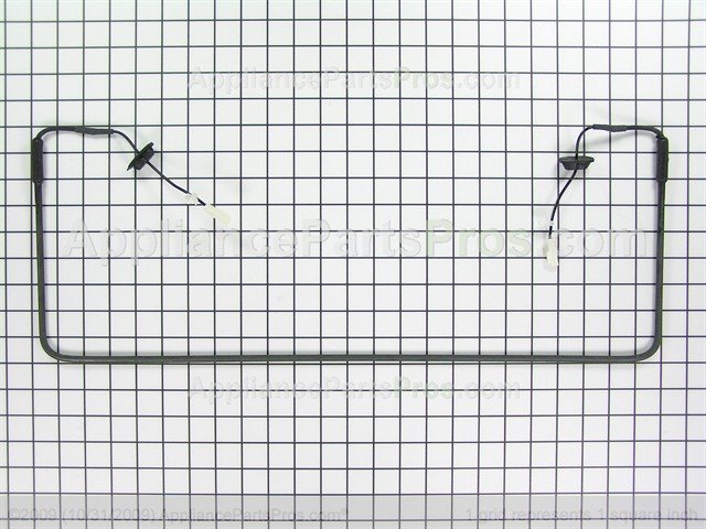

If the defrost thermostat ohms good, then next ohm test the defrost heater. Make sure you disconnect power to the refrigerator before ohm testing!
Here's the defrost heater for your model:
Heater WPW10166768
Here's the video to ohm test it:

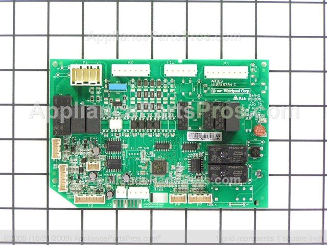

If the defrost heater ohms good, then the main control board is the culprit:
Cntl-ELEK,GF2 Io,xxl Bm, WPW10581606
