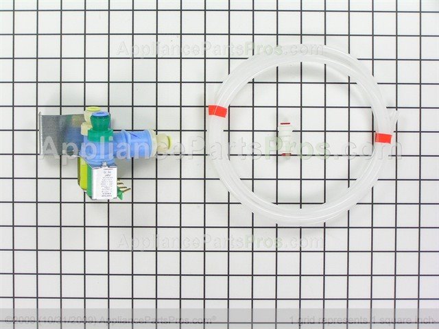

Ok, to make sure its the ice maker that is the cause, turn the water supply back on and then when the water starts flowing out of the ice maker--->unplug the refrigerator from the wall outlet and see the water stops, if so, then its a bad ice maker.
If the water does NOT stop while the refrigerator is unplugged, then the water inlet valve is bad.
W10822681 Valve-Inlt

Ok, so the water continues to pour when the refrigerator is unplugged, so going by your advice, it's the inlet valve.
Exactly where is the inlet valve and is replacing it a job that a noob can do or does it need a professional?
The water inlet valve is located in the back of the refrigerator.
If you've fixed other things around your house, then you should be able to replace yourself.
