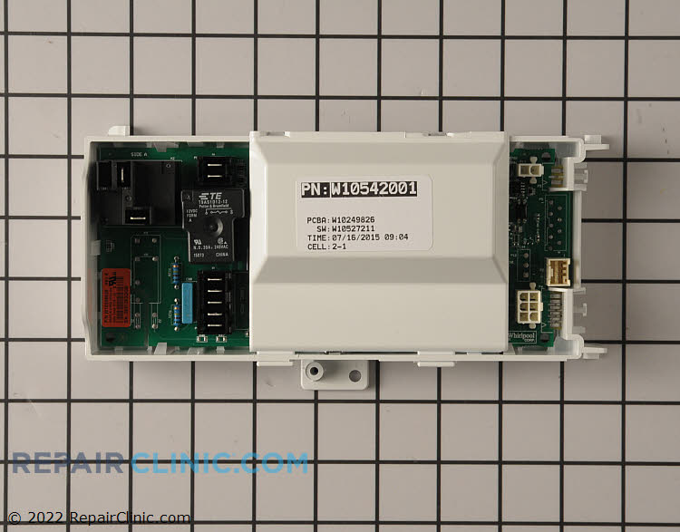

On your model it's common for the machine control electronics to fail. Unplug the machine. Remove the top panel and locate the machine control electronics on the left side. Take the control board out then remove it from the bracket and then turn it over. There's usually a burn mark on the board by the heater relay when it fails. If there's a burn mark, it's bad. If there is no burn mark that doesn't necessarily mean it's good so reinstall it and restore power to the machine. Measure the voltage between the black wire on the heater relay and P8-3 (white wire). Your meter should indicate 120 VAC. Then start the machine on timed dry, high heat and measure the voltage between the red wire on the heater relay and P8-3. Your meter should indicate 120 VAC.
(click to enlarge)
WPW10542001 Electronic Control Board

Thanks Jake, there's definitely no burn mark on the board, and it doesn't show any signs of damage that I can see. I also looked with a magnifying glass and didn't see signs of solder joints failing.
I'll reassemble the machine and try out the other measurements within the next couple of days.

You can run the machine while testing at the control board David, that's the only way to find out which part is the problem child.
davidgut
May 6, 2020
8
Seattle, WA
Do you mean leave the board unmounted but everything else connected, and test at the back of the board? Will that be different than the test that I did to neutral wire at the back of the machine?
137,406
You test from the front of the main control board, see the diagram I posted above where the connectors are labeled?
You only needed to flip the board over to look for any burnt spots on it, not for voltage testing.
